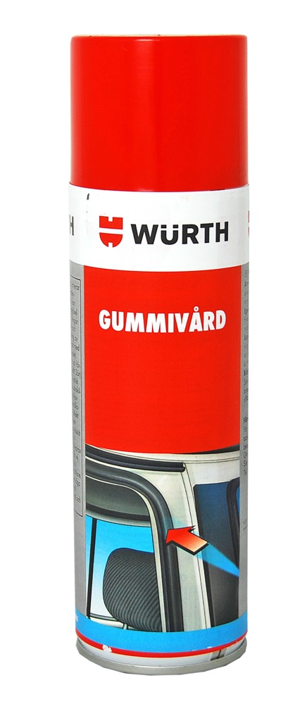

I have been told that you should never use silicone products on the rubber seals, so i ordered a silicon free "gummipflege" product that i have been using.
That said, i have never had any issues with the doors/windows freezing during six Swedish winters, neither before or after i started using the "gummipflege" on my seals.

This is what I also use. https://www.amazon.se/gp/product/B0012AW4RO Gummipflege which doesn't grease up the sides and makes windows slide easier when in sub-zero temps.fth skrev: ↑02 okt 2023 15:48I have been told that you should never use silicone products on the rubber seals, so i ordered a silicon free "gummipflege" product that i have been using.
I also bought this https://www.amazon.se/gp/product/B000U42S42 which is probably as good, but it smears grease that is highly visible on the windows, even after I wipe off any left overs. Therefor this remains unused and not one of my recommendations. (just included because I didn't know the difference)

The first one is more of a ”restorer” (but do also prevent freezing). The second one is the ”best” against freezing, containing vaseline which is GREAT for making rubber seals not freeze and doesn’t harm the paint like silicone. Although it’s way messier than the first one (as mentioned).Jaegaern skrev: ↑03 okt 2023 07:10This is what I also use. https://www.amazon.se/gp/product/B0012AW4RO Gummipflege which doesn't grease up the sides and makes windows slide easier when in sub-zero temps.fth skrev: ↑02 okt 2023 15:48I have been told that you should never use silicone products on the rubber seals, so i ordered a silicon free "gummipflege" product that i have been using.
