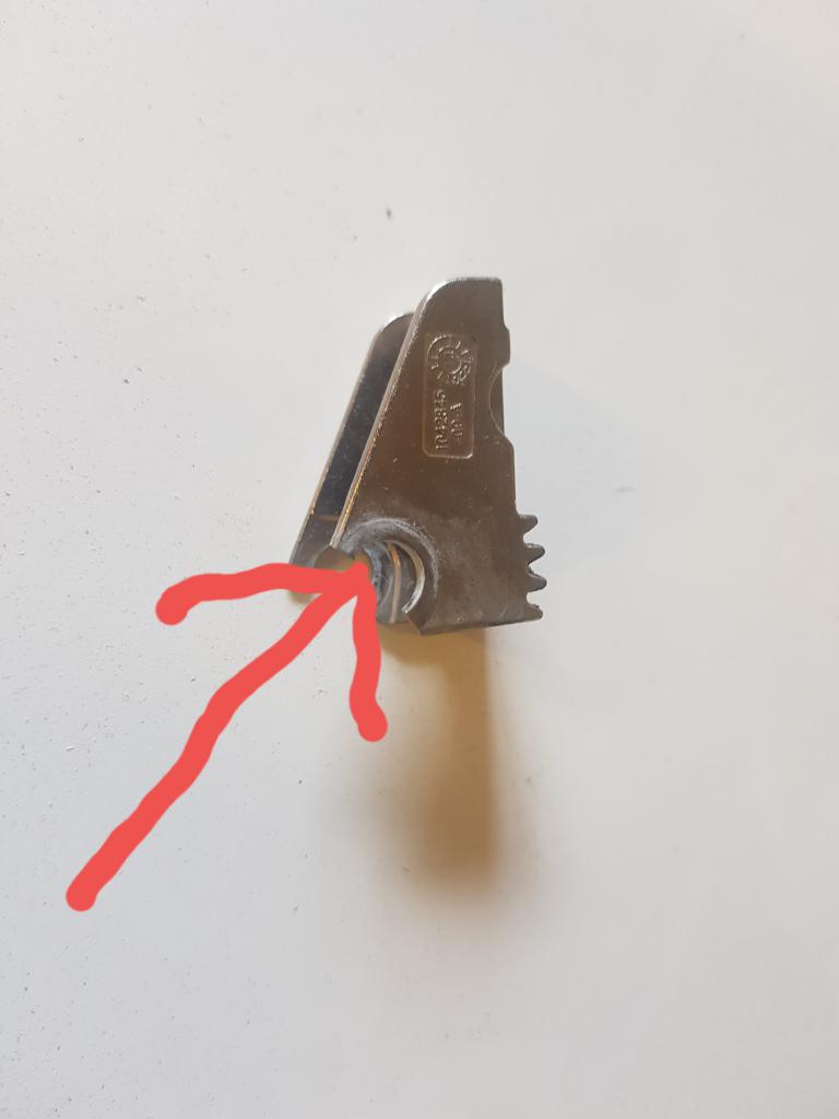

Broken part
Model S85D

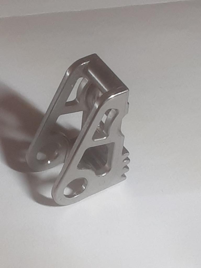

Not yet broken part 1042845-B
ms 76132 "Eleamore"
