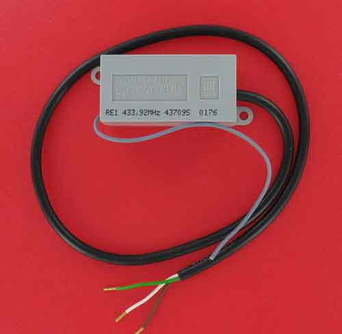

Add a 433 MHz receiver to the Promatic and you will be ok. You allso need a 433 MHz remote to program the car.

Any shops in sweden or I should buy it online
http://www.garage-door-remotes.co.uk/se ... ormann.htm

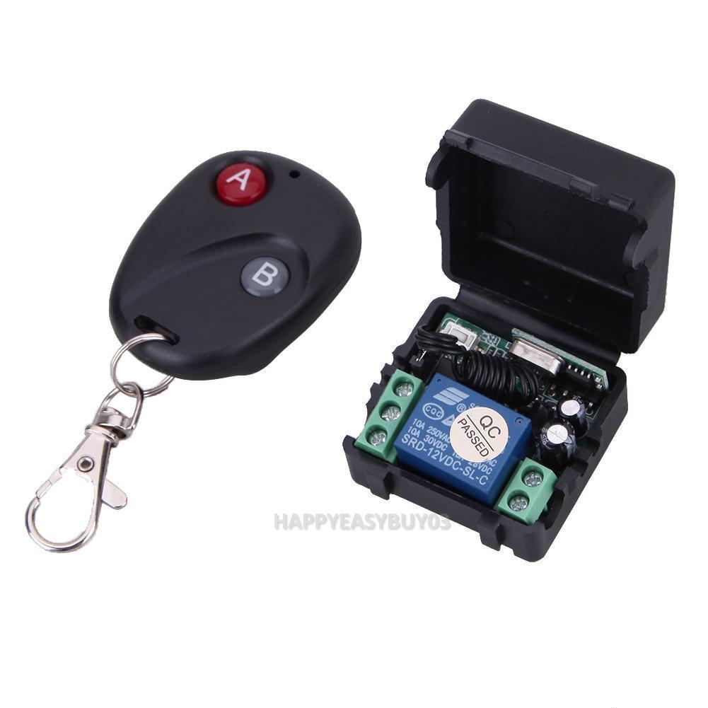

I got this one on Ebay, has been working flawlessly for a year now:
http://www.ebay.com/itm/1x-RF-Remote-Co ... X4jBO#rwid
It doesnt come with instructions, some wiring requiered (it connects to your garage door openers outlet for fixed wall remote).

I got mine from Hornbach. They ordered it from Hörmann and I got it in a couple of days.

Thanks a lot for your suggestions.. I called hornbach.. they will place an order at Hörman.

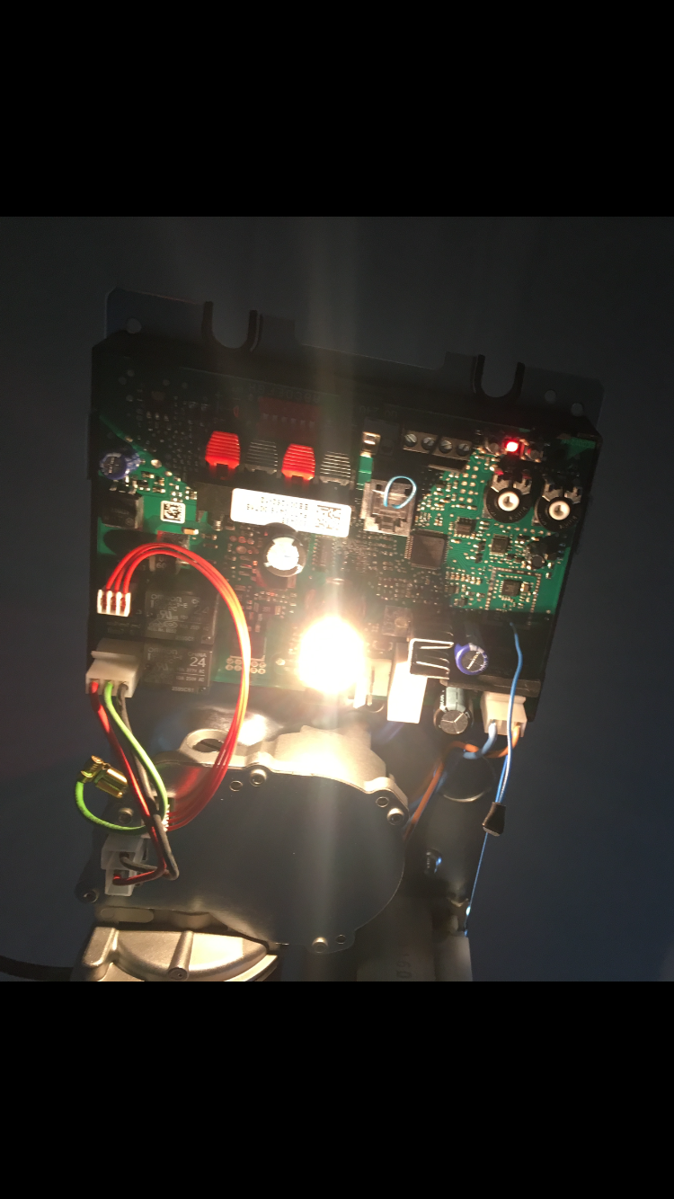

Could anyone help me how to fix this on Horman Promatic Garage opener..
There is no installation diagram to fix this :-(
Did you manage to connect this? If so, how? Have the same opener and stuck without instructions
