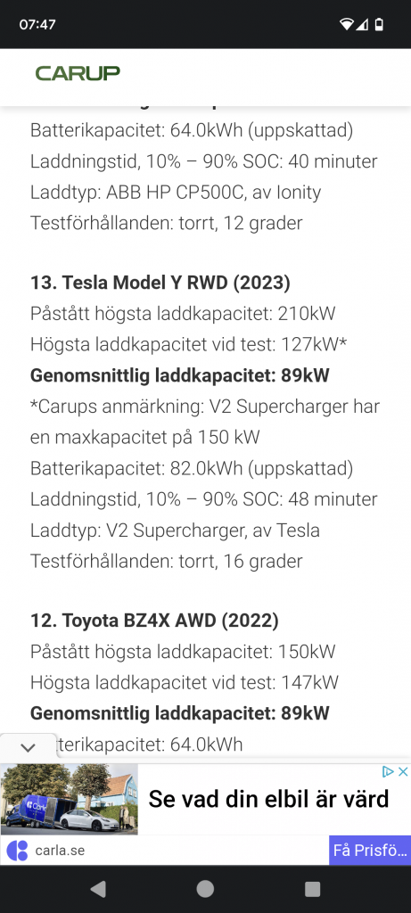

Av någon anledning har de konstruerat en oroligt komplicerad algoritm för denna artikel, och sedan kokat ned den till en enda laddeffekt och en tidsangivelse för 10-90%. Istället för att bara åka och ladda från 10-90% och mäta tiden. :?: :?: :?:
autocar skrev:
Our approach to our rapid charge test is simply to use a rapid charger of sufficient capacity to meet the test car’s peak charging rate; and to observe and record how much power is actually drawn by the car as it passes a 10%, 30%, 50%, 70% and 90% state of charge (SOC).
Practicability dictates that we cannot use the same DC charger for every test and, while we pre-condition the car’s battery before charging where possible, many EVs don’t allow this once battery condition has dropped below 10%.
We then average our test results with a weighting that reflects the need that rapid charging typically meets for EV drivers. Public rapid charging is relatively expensive compared with home charging. Most use it to extend the range of their cars for a particular journey, rather than as a regular habit, and as a result few rapid charge from less than 20% charge, or to beyond 80% (because doing that isn’t time-efficient or beneficial to battery longevity).
For that reason, the rapid charge rate demonstrated by a new car as it passes 50% SOC contributes three times as much towards our aggregated charge rate result as the equivalent rate indicated at either 10% or 90%; and likewise, the rates recorded at 70% and 30% are doubly important as those at the extremes of the battery condition spectrum.
Om de hade faktiskt gjort det hade de upptäckt att det inte tar några 48 minuter att ladda Model Y RWD 10-90, utan snarare 38. Om det nu är någon som bryr sig om 10 minuter hit eller dit.

Är det inte rätt dumt att ha en rad att högsta laddeffekt ska vara 210kW och sedan direkt under att man bara fick 127kW för att sedan under en asterisk gömma att det var SuC v2. Blir ju omöjligt att få 210kW då. Sedan borde ju Max vara 250kW (262kW) om den hade 82kWh batteri
