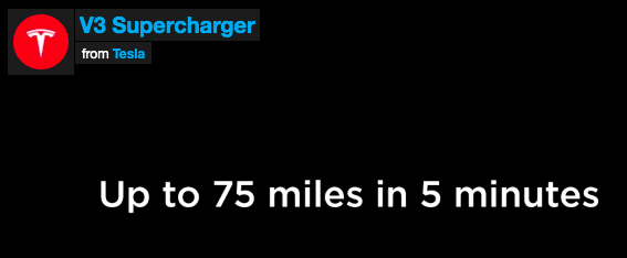

Storedot säger att de kan ladda 100 miles på 5 minuter.
Tesla säger att det kan ladda 75 miles på 5 minuter, under optimala förhållanden.

Re: StoreDot laddar 4680 batteri på 10 minuter?
75 mi på 5 min = 230kW på min M3P.
100 mi på 5 min = 307kW.
Inget av dessa verkar omöjligt. 75 på 5 är väl ungefär det man hinner få under bra förhållanden på SuC V3.

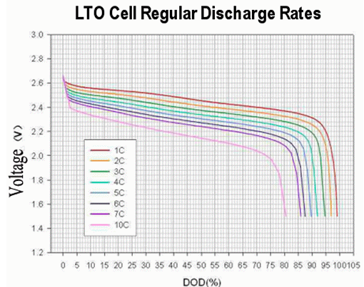

600kw ger 30kWh på 3 min.
Med så litet batteri är man tvungen att ladda 22 ggr per dygn.
Lithium titanate (lithium titanium oxide) batteries have extraordinary long life cycles, fast charging and are much safer than other types of lithium based batteries.
The Lithium Titanate (lithium titanium oxide) technology (LTO) is a solution that is most ideal for mobile energy storage. The LTO cells utilize advanced nano-technology processes to produce anodes with a surface area that is substantially larger than that of other types of lithium based batteries.
This advantage allows Lithium Titanate (lithium titanium oxide) batteries to have a life cycle of up to 20,000 cycles as compared to only 2000 in standard lithium based batteries.
Additionally, the efficiency of the Lithium Titanate technology in energy storage solutions allows for a recharge efficiency of up to 98%, much higher than conventional energy storage mechanisms.
Furthermore, Lithium Titanate offers the highest energy to weight ratio seen yet, creating exciting opportunities for its applications for devices that require a low weight battery, such as light vehicles, e-cars and fork lifts.
Lithium Titanate (lithium titanium oxide) batteries for high power solutions also offer the advantage in that they are able to store and deliver current peaks that are between 30 and 100 times that of ordinary lithium batteries.
